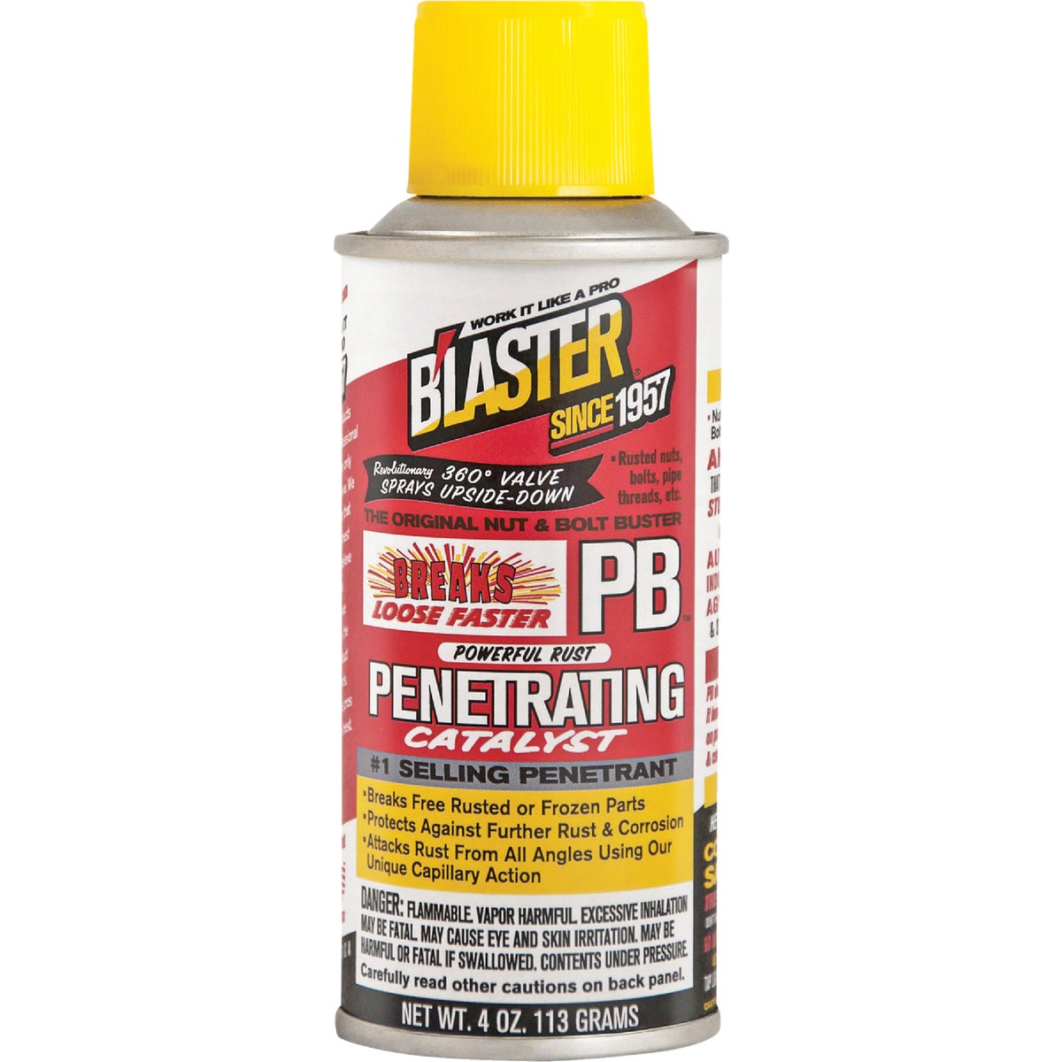

    Only way to get them out is to drill the centers and use an Easy-Out Extractor. A small 90* drill would be your best bet, and make sure you put a few drops of oil on the tip so you don't burn it when drilling through the center of the broken bolts. Also, once you have a hole drilled in them, use some PB Blaster on the bolts and let them soak for about 1 hour before extractinging them.

                **Good news is I told my boss about it today and he has a 90* drill he will let me borrow. I just hope he remembers it tomorrow. I started soaking the sheared bolts in penitrating oil today.
